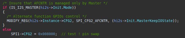

i think, this is obvious error in cube; missing the IOSWAP in SPI_CFG2 to set or wrong setting preset.
to proof , i add pinswap in HAL_I2S.c driver / init slave mode:
now sound is ok again; so data coming from SDO now (again).

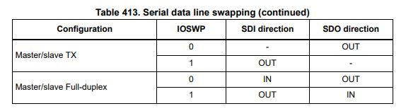

Did you try to change IOSWP bit in SPI_CFG2 register?
hi2s1.Init.IOSwap = I2S_IO_SWAP_ENABLE;
The SPI/I2S offers the possibility to swap the function of SDI and SDO lines thanks to IOSWP bit located into SPI_CFG2. Details can be found in RM0433:
Bit 15 IOSWP: swap functionality of MISO and MOSI pins
0: no swap
1: MOSI and MISO are swapped
When this bit is set, the function of MISO and MOSI pins alternate functions are inverted.
Original MISO pin becomes MOSI and original MOSI pin becomes MISO.
Note: This bit can be also used in PCM and I2S modes.
Please see the "Serial data line swapping" table in RM0433.

and yes, to proove : i changed IOSWP bit in SPI_CFG2 , in HAL lib:
>> SPI1->CFG2 = 0x008000; // test ! pin swap
as i wrote in first post.
so i think, solution is just : make pinSwap available in I2S mode in cube and setting initial to "1" ;
so SDO stays SDO when selecting slave mode from master mode...and reverse.
(seems , not sooo many people have ever tried, to use I2S transmittter slave mode setting in Cube/HAL on H7xx . )

Adding to stm32h7xx_hal_i2s.c @ line 455
else
hi2s->Instance->CFG2 = 0x008000;
solves the issue.
