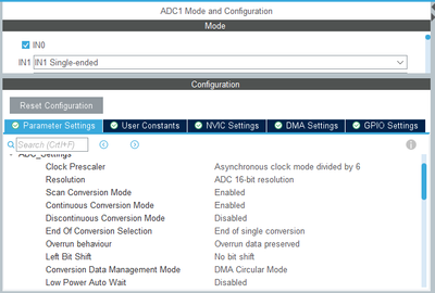

I'm using an STM32H743 with ADC3 in circular DMA mode. ADC has a clockfrequency of 48 MHz. I'm using 8 channels within this ADC3 and also configured the DMA with said channels each with a sampling time of 64.5 cyles. I'm using an async prescaler of 6.

  hadc3.Init.ClockPrescaler = ADC_CLOCK_ASYNC_DIV6;
  hadc3.Init.Resolution = ADC_RESOLUTION_16B;

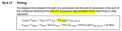

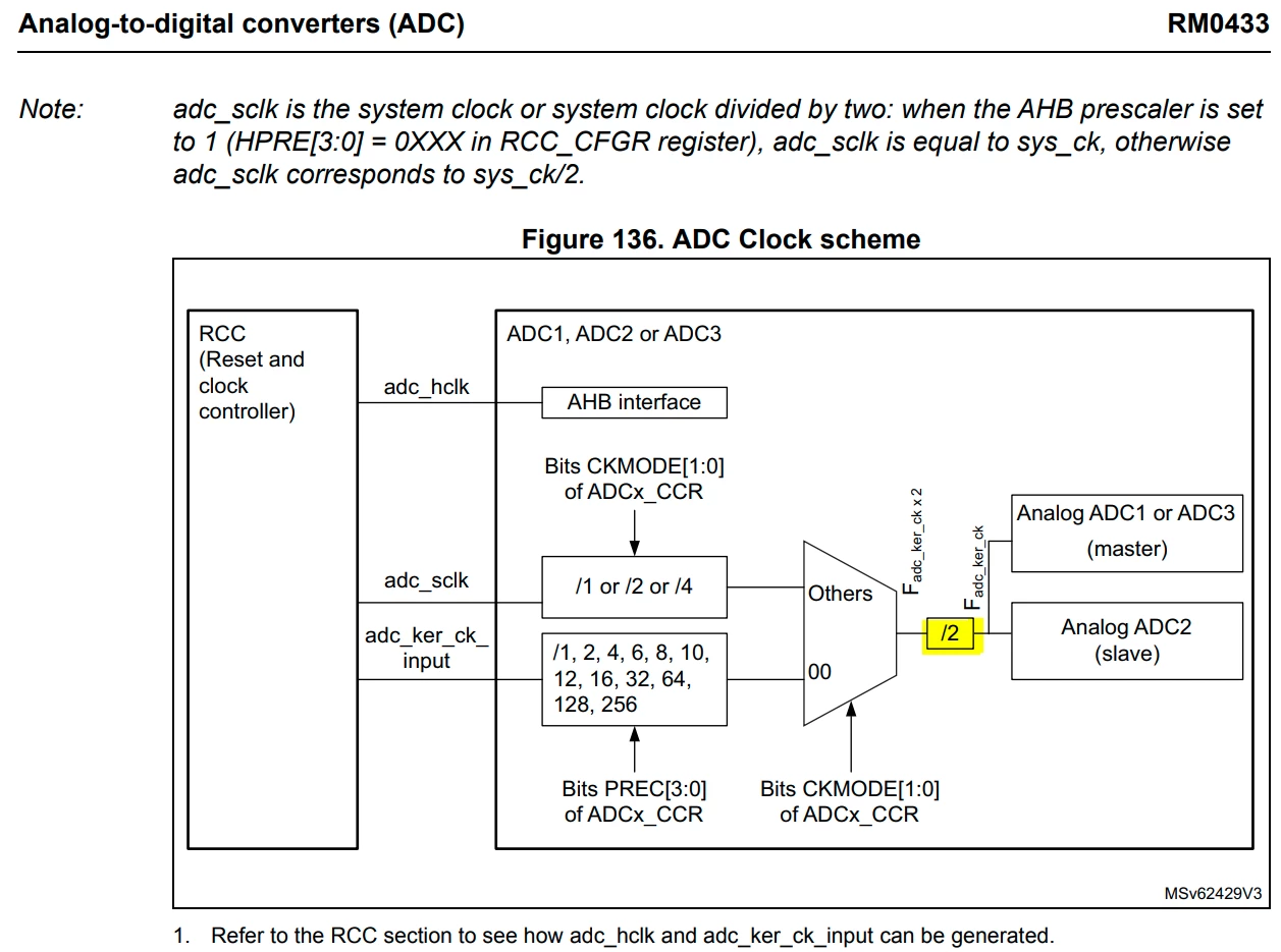

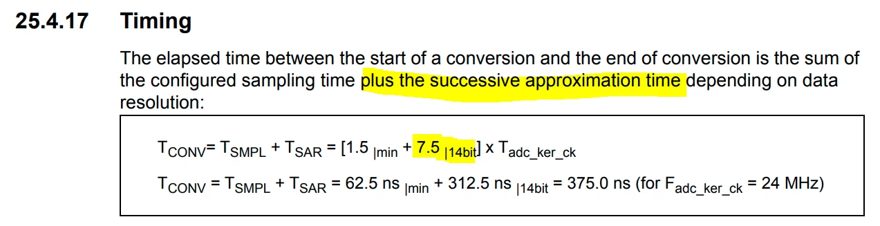

You're missing:
An x2 prescaler on the ADC clock.
Extra samples due to the conversion (would be 8.5 for 16-bit conversion).
