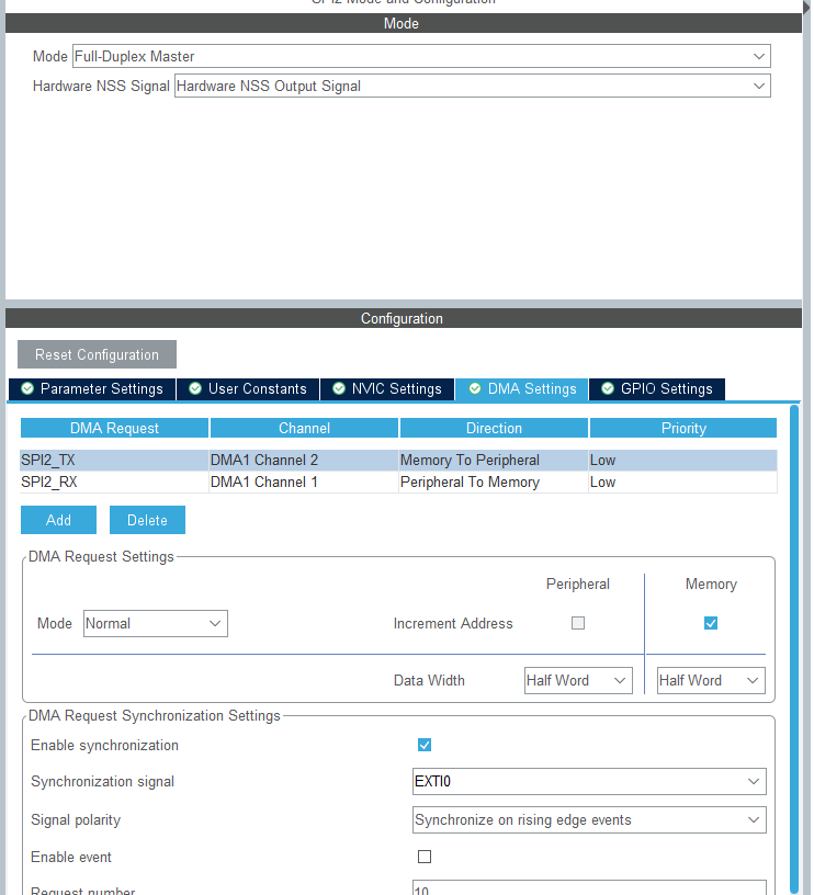

I have an external SPI 8 channel ADC which is connected to the STM32,one of timers would generate a 32KHz 50% pwm signal which is connected to the ADC convert pin, the ADC has a busy pin which is connected to the EXTI0 of the MCU.
The plan is to use the EXTI0 to trigger 8 16bit SPI reads from the ADC, so after gathering 640 samples I would get an interrupt, to process the incoming data, since Interrupting the CPU 32000 times  per second would not allow any other meaning full job to be done,
So I have done like this

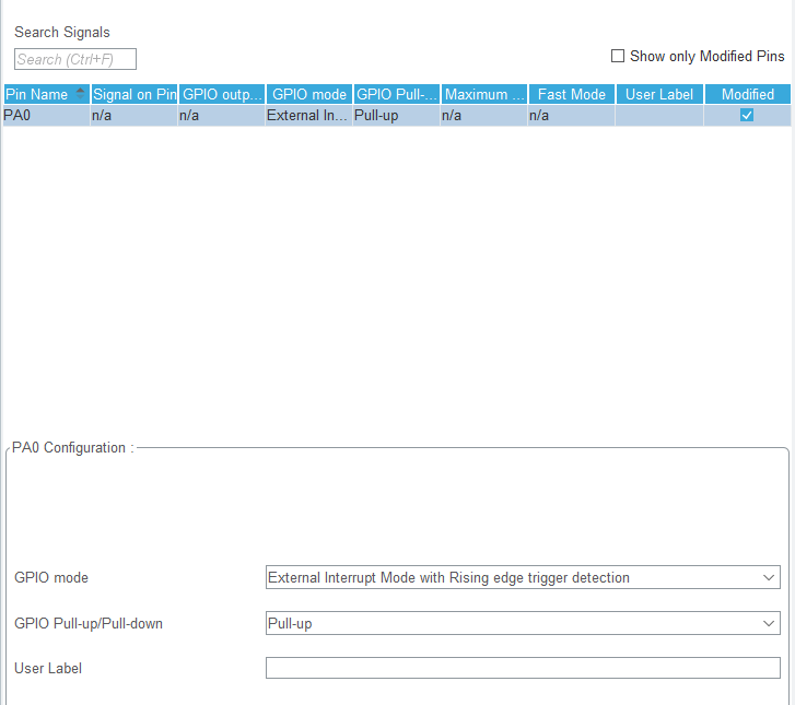

Pin A0 configured as EXTI0
SPI DMA settings

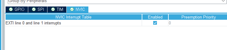

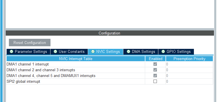

SPI NVIC settings
my code is like this

This code works only when I enable the EXTI interrupt, which would ruin the hole prepose of eliminating the use of interrupts,
Is there any work around this so I would reduce the CPU overhead and interrupts, so the CPU could do other time critical tasks.
