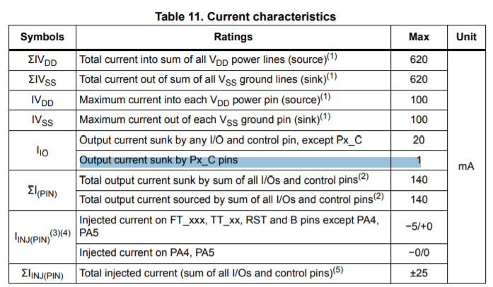

I would like to bring to your attention a particular condition mandatory to make Px_C pins work properly on STM32H735 devices (highlighted in AMR conditions in product datasheet:(
0693W00000DpnOGQAZ.pngIt is mandatory to not exceed 1mA as output current sunk by Px_C pins.
-Amel

About the table you are citing: yes, I know about that. I have to disagree with you a little: this should mean that output current sink is 1mA, no? Not that output current must not exceed 1mA, since it is written like that. This would mean that the falling edge would be slower, not both rising and falling. Limitation really about output current I did not find anywhere. Therefore, we do not think that this is the culprit. We are starting to think that this issue is some limitation in the sillicon, but we may be wrong.
Karel
Right! I edited my post.
That's curious & still need some more investigation.
-Amel
