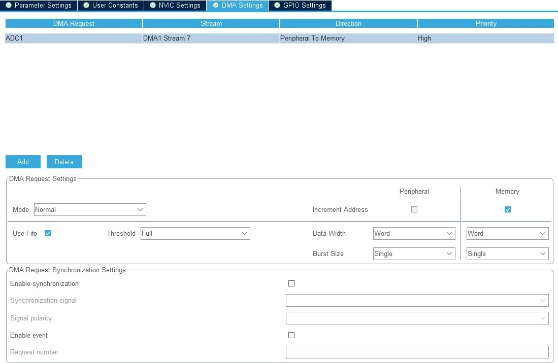

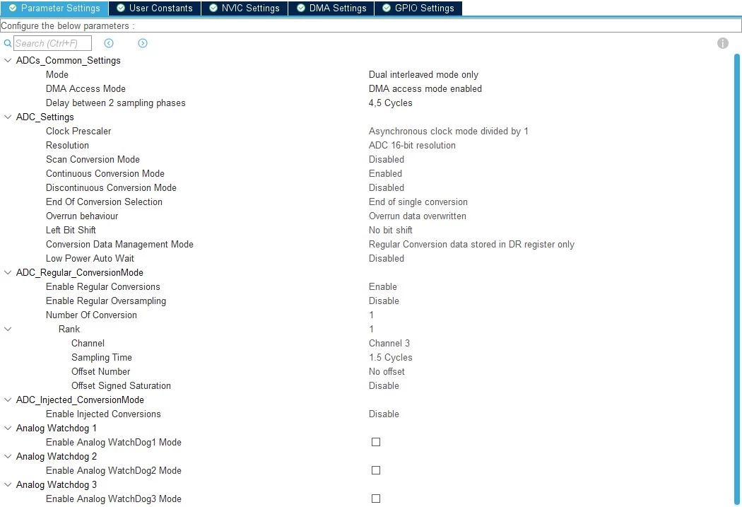

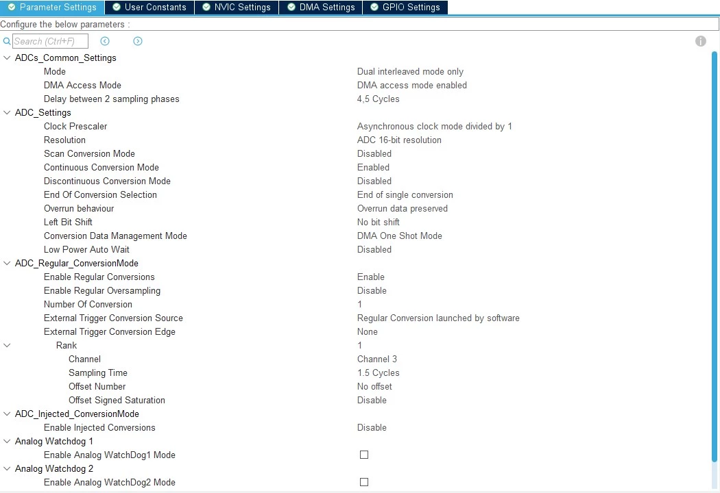

I am working on STM32H735RGV6 for interleaved mode single dma. I am having problems while getting samples from the DMA controller with ADC. The problem is as the following.
1. If I want to get 8192 or a smaller number of samples, there is no problem. I am getting the whole sample.
2. If I want to get 8193 or greater samples, then a DMA transfer error occurs.
The following pictures show my setup for ADC1 and ADC2.
ADC 1 settings
ADC 2 settings
ADC 1 DMA settings
#define ADC_DMA_BUFFER_SIZE (16384)
volatile __attribute__((section(".dma_buffer_ram2"))) uint16_t ui16pAdcBuffer[ADC_DMA_BUFFER_SIZE];
ui16pAdcBuffer --> It is in RAM_D2
ADC DMA calling function setup 1: the following setup works well many times without any problem and I am getting HAL_ADC_ConvCpltCallback each time I want samples from ADC
ui32AdcDataSize = 8192
if(HAL_ADCEx_MultiModeStart_DMA(&hadc1, (uint32_t*)ui16pAdcBuffer, ui32AdcDataSize) != HAL_OK)
Error_Handler();
ADC DMA calling function setup 2: the following setup is not working. When I want 8193 samples from ADC I am getting ADC_DMAError and HAL_ADC_ConvCpltCallback is not called.
ui32AdcDataSize = 8193
Error_Handler();
The number 8192 is somehow interesting. Likely, it tells me that there can be a limit on ADC-DMA but I am not sure about it.
Could you help me with this issue?
Best regards,
Ersin

Hello @Ersin Kuscu
The maximum length of data to be transferred from ADC peripheral to memory should be in 256 x32 =8192.

The transfer size is defined by the DMA_SxNDTR register value and by the peripheral side (ADC1) data width.
According to the reference manual, a stream has an independent 4-word (4 * 32 bits) FIFO.
To ensure that the last burst transfer is not incomplete, the total number of data items must be multiple of the burst size multiplied by the data size.
For more details, you can either check the reference manual 15.3.12 Programmable data width, packing/unpacking, endianness, or Using the STM32F2, STM32F4 and STM32F7 Series DMA controller
