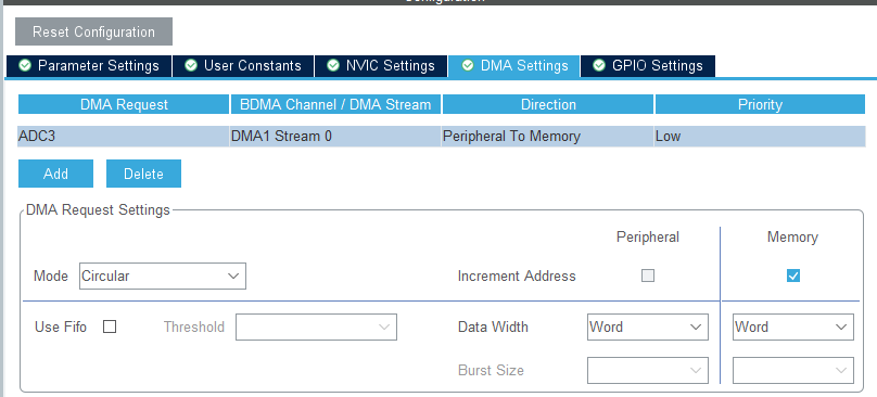

I am using an STM32H723ZG MCU and wanted to use ADC scan conversion with DMA. I could implement what I wanted there is just one thing I do not fully understand related to it.
I am using ADC3 whose maximal resolution is 12 bit. Based on the reference manual of the MCU, the data of the ADC conversion is stored in a 16 bit register.
0693W00000SvHk2QAF.pngWhen I configure the DMA, I have to choose Word as the data width. Word means 32 bit here.
0693W00000SvHlAQAV.pngMy question is: Why? Why do I have to set the data width of the DMA 32 bit if the result of the ADC conversion is stored in a 16 bit register?

GVG
Hi @RomainR.​ ,
Yes, I can choose Byte or Half-Word as well. However if I do so, then my ADC results are not transferred from peripheral to memory properly.
Maybe I should have asked my question in a more general way. I could look at the MemDataAlignment field in DMA_InitTypeDef structure (both in the source code and in UM2217 HAL Driver description). This is the field in the .ioc file /CubeMX I am asking my question about. UM2217 says that the MemDataAlignment "Specifies the memory data width". Where can I find that what is the memory data width in case of the STM32H723ZG MCU? I couldn't find it either in MCU datasheet or in Reference Manual. (Sorry for the silly question, I'm a beginner.)

Piranha
Chief II
A good example of why the respective sections of the reference manual should be read first. RM0468 section "15.3.9 Pointer incrementation" explains it. In your case set both sides to 16-bit (half-word) and, of course, provide an array of uint16_t integers.
MasterT
Lead
You have options to select word - 32 bits because some ADC supports dual mode configuration. Joining two ADC together helps to increase sampling rate twice, and data becomes "packed" as two 16-bits values into one word, so DMA save times to push two conversion results at ones.
Byte size DMA in case ADC configured for lower resolution , 8 or 6 bits. In case faster sampling rate required.
Just configure both ends peripheral & memory to the same width. No error if you will set 32-bits words, just more memory would be necessary - not big deal for small project.

Yes, it did help, thank you. Based on the example you referenced I could understand what I was doing in a wrong way and fix it.
Just one last question: Why is the ALIGN_32BYTES needed? It works for me even without it.
Indeed, you are absolutely right. Thank you for your answer.
If you mean D-cache maintenance, then just aligning an address is not enough.
