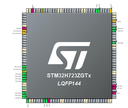

Project Configuration:
  • Microcontroller: STM32H723ZG
  • Motor Drivers: Rhino RMCS-2303 (Quantity: 2)
  • Motors: Rhino DC Motors (Quantity: 2)

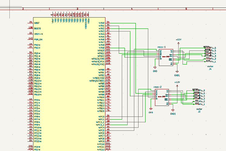

Hardware Setup:
Motor 1 (Left Motor):

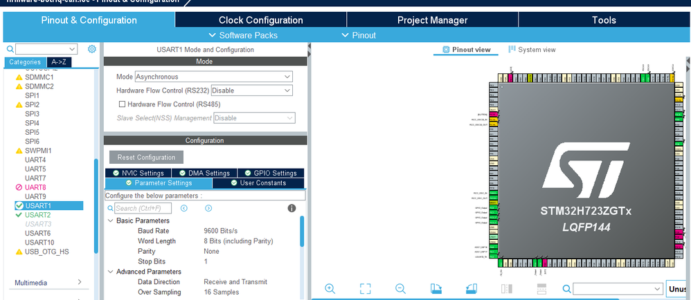

  • UART Communication: USART2 (PA2-TX, PA3-RX)
  • Control Pins: ENA (PC0), DIR (PC2), BRK (PC4)
  • Feedback: ADC (PA0) - Optional
  • Slave ID: 7
Motor 2 (Right Motor):
  • UART Communication: USART1 (PA9-TX, PA10-RX)
  • Control Pins: ENA (PC1), DIR (PC3), BRK (PC5)
  • Feedback: ADC (PA1) - Optional
  • Slave ID: 6

Issue Faced:
However, I am facing difficulty in controlling the motor speed dynamically. The motors continue to run at the same speed regardless of the speed command I send. I am unable to increase or decrease the speed using commands.
Could you please guide me on:
  1. The correct command format/protocol for speed control with RMCS-2303?
  2. Any specific register settings or UART command structure I should follow?
  3. Whether any additional configuration is required in the driver settings?
