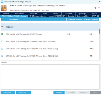

     Below is the package which I'm using.

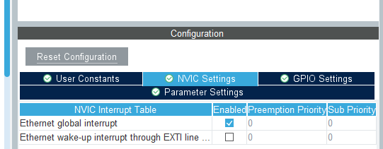

Hello @max67,
After reviewing your project, I believe the only issue preventing it from working properly is that you mistakenly enabled the Ethernet global interrupt in the Ethernet settings. If you disable it, it should function correctly. Please do so and let me know whether it works.
Best regards,
To improve visibility of answered topics, please click 'Accept as Solution' on the reply that resolved your issue or answered your question.
Hello @STackPointer64,
       As you said, I did disable the Ethernet interrupt and build the project. I checked the Ip address and try to ping it but still can't ping it. I still got destination host unreachable error when I try to ping.

Hello, @STackPointer64
I tried the example with another PC , with another cable and still facing the same issue. I checked subnet and it is same as in board and checked it also in another PC. I turned off the firewall also.
Could you please provide what version of STMCubeIDE are you using and firmware package which helps a lot.
I provided my version and firmware package in the first query.
