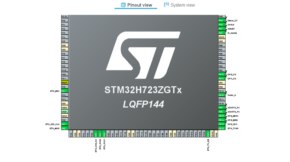

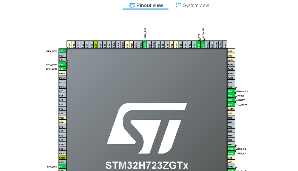

Thank you for your reply.
I have used the default Ethernet pin configuration. For your reference, I have attached the corresponding screenshot of configuration andStm_1.pngStm_2.png .ioc file. Kindly have a look.
Currently, both D-cache and I-cache are disabled.

I can see the TX pins are not the right ones. TXD0 should be PG13 instead of PB12, TX_EN should be PG11. Please check all the pins and compare with the board's schematic. I am running an example on my Nucleo H723 with these changes and all works.

I have reviewed the Nucleo-H723ZG schematic and updated the pin assignments accordingly. Specifically, I have corrected the RMII pins as suggested (TXD0 -> PG13, TX_EN -> PG11, and TXD1 -> PB13 ), and verified the overall pin configuration in my .ioc file to match the board schematic.
