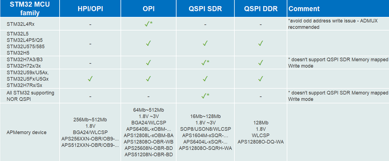

There are definitely some issues with some STM32H7 devices and some APS memory. Perhaps @Alex - APMemory can weigh in. There is a spreadsheet but it's incredibly hard to find by searching. Ahh, here it is:
Re: H723 - OCTOSPI: device's page size and wrap se... - STMicroelectronics Community
Related:
Memories compatible with QUADSPI, OCTOSPI, HSPI, a... - STMicroelectronics Community

Hi @Luca G. ,
The read/write latency should be default value after
Application_ResetMemory() so that you should set read/write latency as 5 in Application_Init():
unsigned int Application_Init(void *memory_ptr)
    bool failure = false;
    unsigned int ret_value;
    read_layency_code = APS512XX_READ_LATENCY_5;
    write_layency_code = APS512XX_WRITE_LATENCY_5;
    if (false == Application_ResetMemory())
