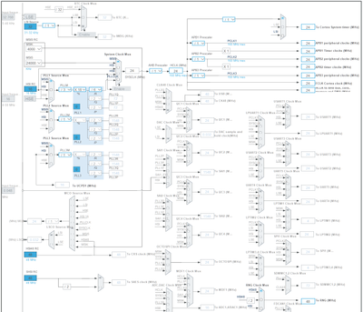

I am using an stm32u585, specifically the b-u585i-iot02a development kit board.
I set up a basic project using stm32cube ide to test clock configurations. System is clocked from the MSIS at 24MHz with PSC of 1 -> HCLK is 24MHz.
I enabled the RNG peripheral, clocked with the HSI48. In the default SystemClock_Config() function I commented out the code related to enabling the HSI48. RNG initialization is left as default.
Interestingly, the RNG can still generate random numbers with HAL_RNG_GenerateRandomNumber(). The MX_RNG_Init() function succeeds as well.
Reading HSI48ON and HSI48RDY bits from the status registers give both values as 0.
How is the RNG still working and generating valid numbers?
Another curiosity: In this state, the whole MCU takes less power than if I leave the SystemClock_Config() as generated (explicitly enabling the HSI48).
See code snippets below:

clock configuration:
1 REPLY 1
Shirley.Ye
you can check the RNGSEL field in the RCC peripheral clock selection register, whether it is select the HSI48
