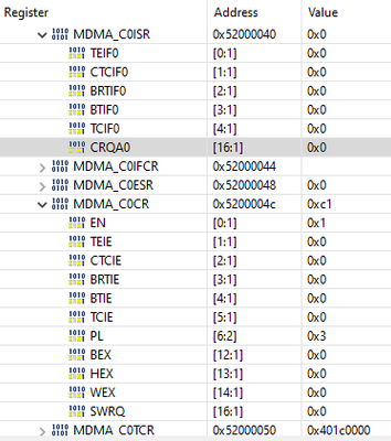

I ran a more basic test without involving the OCTOSPI peripheral, just trying to copy from memory to memory. I'm triggering the request through software. Still no movement on the MDMA controller. This is my code:
uint8_t testSrc[8] = {1,2,3,4,5,6,7,8};
uint8_t testDst[8] = {0,0,0,0,0,0,0,0};
RCC->AHB3ENR |= RCC_AHB3ENR_MDMAEN;
MDMA_Channel0->CCR &= ~MDMA_CCR_EN;
MDMA_Channel0->CCR = 0x0000;
MDMA_Channel0->CCR |= (0x3 << MDMA_CCR_PL_Pos);
MDMA_Channel0->CTCR = 0x0000;
MDMA_Channel0->CTCR |= (0x0 << MDMA_CTCR_SSIZE_Pos) |
(0x0 << MDMA_CTCR_DSIZE_Pos) |
MDMA_CTCR_SWRM |
(0x7 << MDMA_CTCR_TLEN_Pos); // Transmit 8 bytes
MDMA_Channel0->CSAR = (uint32_t) &testSrc[0];
MDMA_Channel0->CDAR = (uint32_t) &testDst[0];
MDMA_Channel0->CIFCR = 0xFFFFFFFF;
MDMA_Channel0->CCR |= MDMA_CCR_EN;
MDMA_Channel0->CCR |= MDMA_CCR_SWRQ;
After executing the last line nothing seems to happen.This is the state of relevant registers:
SWRQ is not changed, nor CRCQA0. I suspect there is something in the MDMA init that I'm missing because it doesn't even give me an error flag.
Any input is greatly appreciated.
Visques
Got the MDMA to work transferring from memory to memory. Will add the OCTOSPI later.
