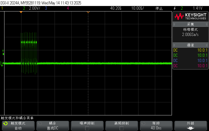

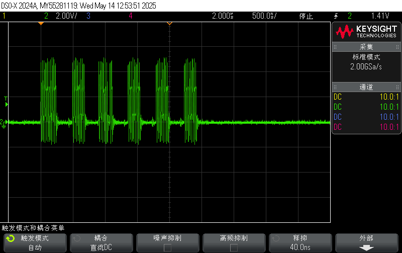

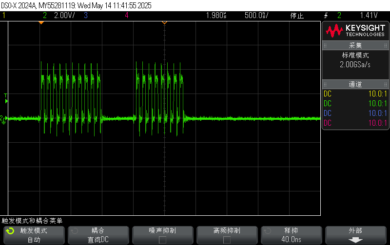

}Run the code, dma doesn't transmit anything via octospi.
if I run the code below with the same configuration, I can get signals on oscilloscope.
void main(void)
while(1) {
OCTOSPI1_WriteData(QSpiTable, 2);
HAL_Delay(1);
void OCTOSPI1_WriteData(uint8_t* data, uint32_t length)
for (uint32_t i = 0; i < length; i++) {
while (!(OCTOSPI1->SR & OCTOSPI_SR_FTF));
*(__IO uint8_t*)&OCTOSPI1->DR = data[i];
}Does anyone have the experience about octospi inidrect write mode with dma?
Is it possible to make octospi (quad spi) work as same as spi, just with more IOs?
2025-05-07 1:47 AM
Another question: Does octospi works under dma circular mode?

2025-05-13 6:53 PM - edited 2025-05-13 10:04 PM
Just now I tried again to send 4bytes under 1MHz, 10MHz and 40MHz octospi clock,
octospi under dma normal works well.
If change to dma circular, (see the pics)
1MHz clock: works just like dma normal, data is transmitted just once.
10MHz clock: Command sent once, followed by sending data twice.
40MHz clock: Command sent once, followed by sending data 6 times.
Something weird:
1. there is some obvious delay during dma return to the head.
2. DMA stops after 2~2.5uS under 10MHz and 40MHz.
Could you share your test code under dma circular?
