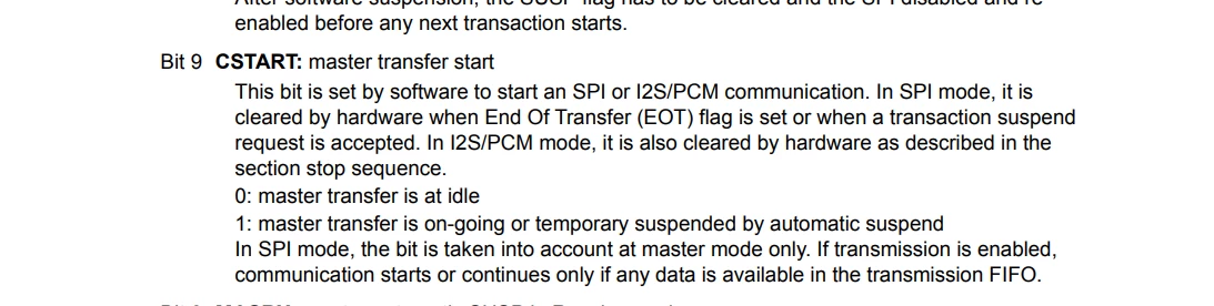

STM32H743 How to start SPI DMA transfer by event
I have a ADC chip connected via SPI to STM32H7x MCU. MCU is master spi, and ADC sends "Data ready" signal whenever new values are ready to transfer. I need sampling rate above 100000 samples per second。If i listen to external interrupt (Data Ok) and calls SPI transfer to read valus, the cpu is getting interrupted too many times and i can’t do anything else。
CSTART is set by software to start spi communication. Is there a way to start tranferring when external event or other event?

Probably AD-7616 , no "s".  I see that adc works with internal oscillator, than conversion clock cycles unknown as frequency of the oscillator.
Well, I see 3 options to interface adc:
  1. Two timers, one generates for CS, another (gated mode driven by CS event) - SPI clock.
  2. I2S, PCM mode. Provide higher frequency (PWM) clock to ADC that is synchronous to I2S frame rate, than you don't need to read DR pin.
  3. stm32H7 has NSSP - nice feature I discovered recently. Pity other stm32 uCPU product lines doesn't have.
Option #1 explained here:
https://community.st.com/t5/stm32-mcu-products/spi-with-dma-add-delay-between-bytes/m-p/227885#M50764
Universal method, for any uCPU even w/o I2S.
For H7 I 'd recommend option 3 - NSSP, read Reference Manual RM0433 for details.

Option #3,I saw the example. I need to use HAL_SPI_TransmitReceive_DMA to start SPI-DMA transmission in interrupt sevice routine, which is not good choice when using a relatively high frequency. I was hoping that the SPI DMA transfer could be triggered automatically by some event.
