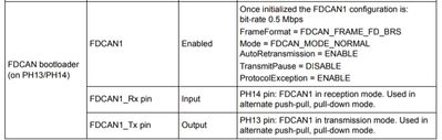

I Have worked with STM32h723 arm processor FDCAN bootloader. but I faced a strange problem in writing data into flash. I can successfully make processor go to FDCAN bootloader and get responses from it but can't write data in some address.(see images)
for example, I can write data in address 0x08000000 and 0x08000004 but I can't write data in 0x08000008 or 0x0800000C. it will filled with 0 or remains 0xFFFFFFFF.

Have you verified that your configurations are compatible with configuration in system memory boot mode :
 Best regards.
II
FBL
Hello @majid1 @Issamos,
Thank you for bringing attention to this I've just checked PH13 /PH14 are not detailed in the datasheet. So, you need to configure PD0/PD1 instead. An internal ticket 161018 is submitted to update AN2606.
