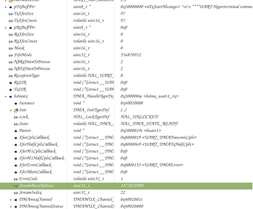

I'm using STM32H753BI. Here i'm using USART1 (PA9 & PA10) in DMA Mode. That code is generated by cubeMX and also i tried the example program of STM32H743-EVAL Board. Both are not working.

Tx buffer (aTxStartMessage) is at 0x20000000 and that's DTCM which is not accessible by DMA.

What does "not working" mean here specifically? How do you know it's not working?
‎2021-04-30 8:13 AM
DMA does work on the H7/UART
I suspect you're going to have to be more attentive to the memory buffer addresses, cache coherency, and program flow here.

If the interrupt and polled versions transmit successfully the UART works.
If the DMA isn't sending the expected data, check the buffer address
‎2021-05-02 11:13 PM
Yes, interrupt and polled version transmission is working fine.
verified the buffer address, it is correct.
HAL_DMA_ERROR_TE error bit was set while transmitting the data.
Tell us that address.

Thanks for your response. Here I'm mentioned the DAM Address. Buffer Address is 0x400200xx..

‎2021-05-04 12:04 AM
