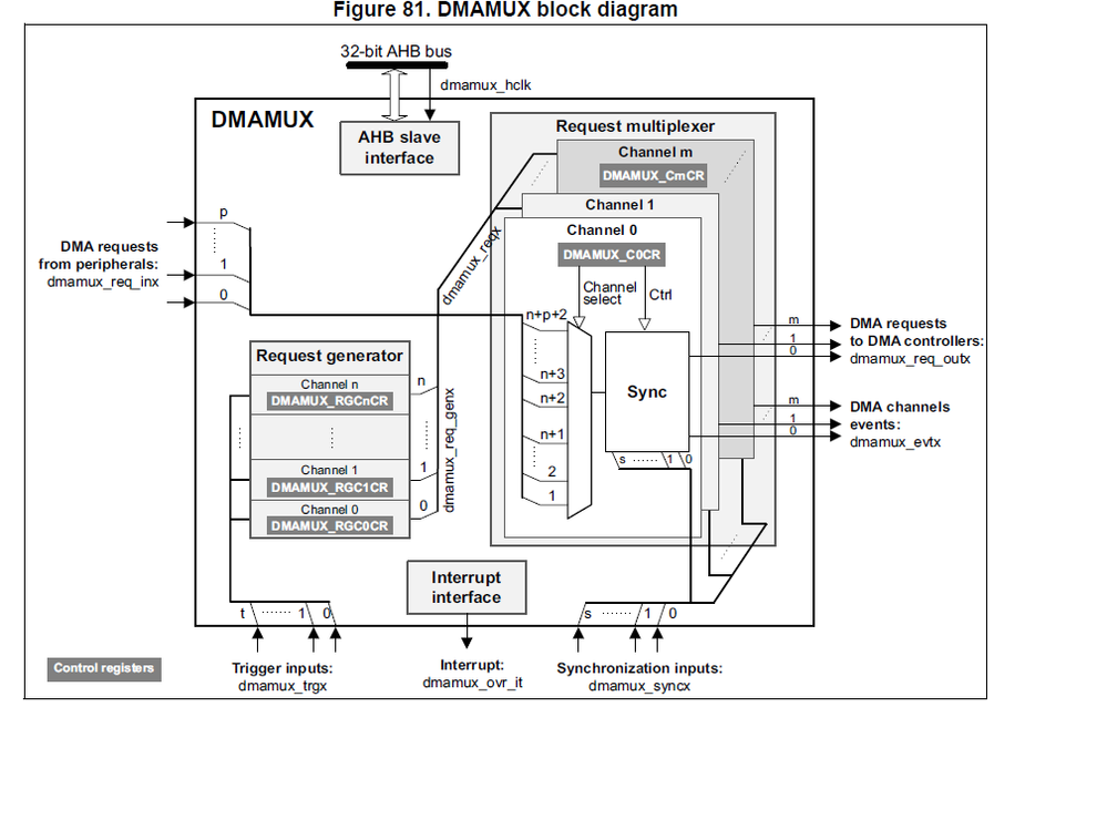

The block diagram - copied below
Seems to indicate that we can have a DMA_REQUEST from peripheral not processed until a Synchronization input is present.

I think what you are suggesting is setting up the DMAMUX request generator and using the EXTI input as a trigger to write to the SPI TXDR register directly? - That could work but I am a bit confused as to why the above setup should not work especially since the block diagram seems to indicate that this scheme is feasible - but again as I mentioned initially I am still confused on exactly how the DMAMUX works and the empirical results I am getting are confusing me even more...
