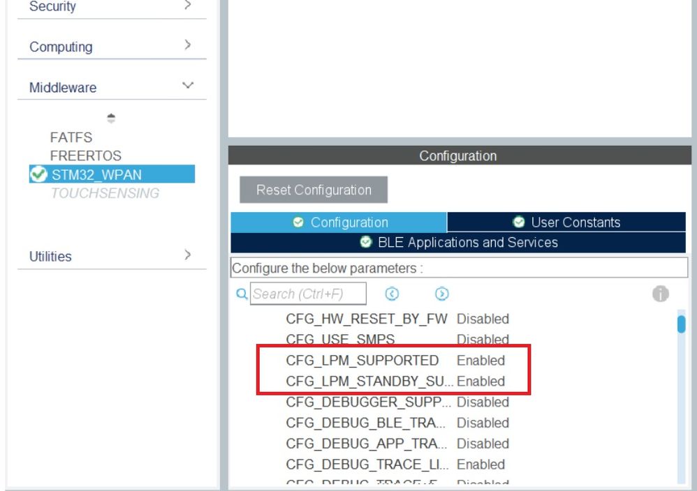

I have this issue:

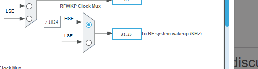

I have set the RF wake up clock selection to HSE /1024 and I cannot get a BLE connection to hold.
Why is that? Any other configuration might be affecting that?
PeriphClkInitStruct.RFWakeUpClockSelection = RCC_RFWKPCLKSOURCE_HSE_DIV1024;  // BAD
When I revert to LSE it works fine.
1 REPLY 1

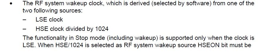

Hi @Community member​  ,
Could you please check your project's low power configuration? It should be disabled if you select HSE/1024 as RF system wakeup clock.
I do not know which specific device you are working on, but just as an example, you can find the information in RM0434 Reference manual of STM32WB55 at page 204/1530.
0693W00000YAoyRQAT.jpgBest Regards,
