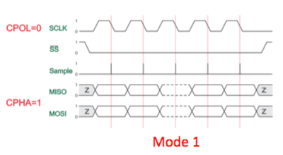

The rising edge of blue signal(SCK) is not lining up with green rising edge (MISO) as I am operating in SPI mode 01 where the data is sampled at the falling edge of the clock or blue signal. For 18 MHz it samples 15.2 ns prior to falling edge of clock while for 25MHz the timing reduces to 7.8ns. Hope this helps to understand the scope readings better.
I am aware it’s in SPI mode 1. Things should still be aligned as stated.
I could have been a bit more clear. Here's SPI mode 1:
Note how the rising edge of SCK corresponds to edges on MOSI.
On your scope trace, edges of MOSI are slightly delayed from the rising edge of SCK.
What is the master SPI here?
Amit_RS
The Master is the PI CM
Amit_RS
I just checked this delay on oscilloscope and it is quite persistent across all ranges of frequency from 1MHz to 31MHz. The delay is around 10ns and it doesn't change with any increase or decrease in frequency.
