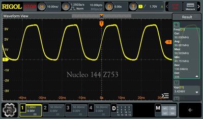

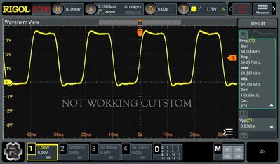

I have probed the REF_CLK of 3 boards, a working, non working and nucleo 144 Z753 for comparison. Looks like I am within tolerance no? I have attached those scope captures of each of the 3 boards REF_CLK, with a 150mhz probe and spring clip.
It seems like the TX lines are working on the non functioning boards but there is a problem with the RX? The router is able to see the device connected at its assigned IP, the MAC is read correctly, but pings from the PC dont receive back.

Just from your scope pics - what you set the pin speed to ?
Try setting all pins used here to medium or med./high - and then check working....
(to reduce reflections, because these cpu's are really fast switching on the pins )
