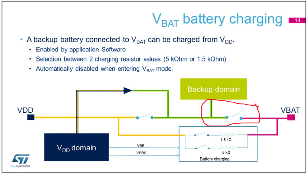

I am working on a project with STM32H753 MCU and I want to reset the back up registers of the MCU every time I reset the MCU. With VBat presented on my board via external battery. The only way to do this is by writing to the specific register referred in the Datasheet or is there a Pin that can be handled by software and disconnects the back up domain from the VBat voltage? For more explanation I add the bellow photo. My Question is if I can handle the switch marked with red color in the picture by a Pin?
2 REPLIES 2
waclawek.jan
This is an unreasonable request. The purpose of backup registers is, that their content persists even during VDD being unavailabe, i.e. through a power reset.

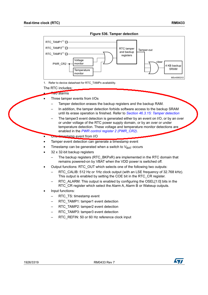

Also, removing power is not the proper way to reset the backup registers. You can simply write to them zeros. Also, they are cleared by tamper, read the RTC chapter in RM.
> The only way to do this [disconnecting VBAT from backup domain] is by writing to the specific register referred in the Datasheet
Yes.
No.
