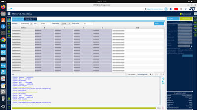

I am using the STM32H7B3I-EVAL board with STM32H7B3LIH6Q controller.
The board revision I am using is MB1370-lcd-b02 a254300030.

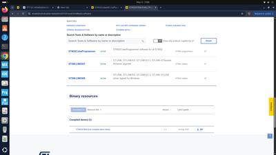

I downloaded the official demo package from the ST website:
STM32H7B3I-EVAL → Tools & Software → Demo Code Package.

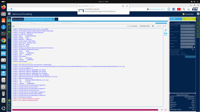

After extracting the ZIP file, I tried flashing the provided  .hex demo file into the controller using STM32CubeProgrammer.

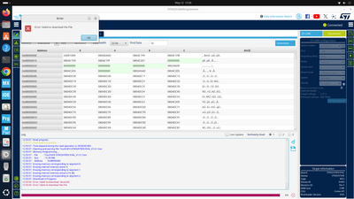

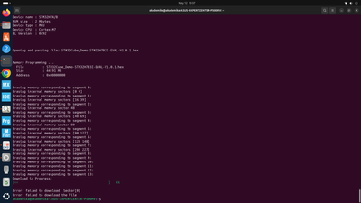

However, programming fails with the following errors:
  • Error: failed to download Sector[0]
  • Error: failed to download the File
The board is detected correctly through ST-LINK, and connection is successful. I already tried:
  • Reducing SWD frequency
  • Full chip erase
  • Hardware reset / Under reset mode
But the issue still occurs.
Could anyone please suggest:
  1. Whether the provided demo .hex file is directly compatible with STM32H7B3LIH6Q?
  2. If any special option bytes or external memory configuration is required?
  3. Whether the demo depends on external QSPI/OSPI memory or specific boot settings?
Thank you.

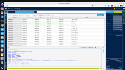

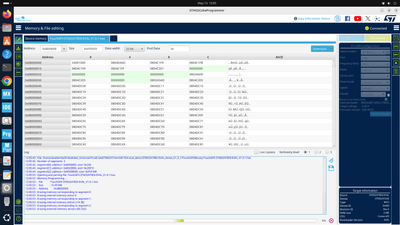

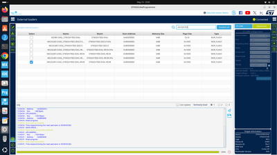

Hello @vijayajangam ,

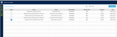

This demo requires an external QSPI memory to be present and properly initialized.
For the STM32H7B3I-EVAL board, please use the correct OSPI flasher:
MX25LM51245G_STM32H7B3I-EVAL
To program the board, open STM32CubeProgrammer, go to External loaders, and select the QSPI/external loader matching your board configuration, as shown in your screenshot.
Once the correct external loader is selected, you should be able to flash and run the demo properly.

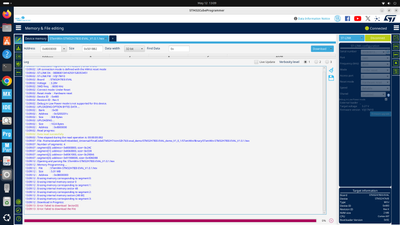

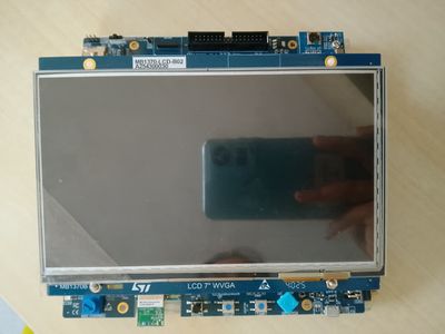

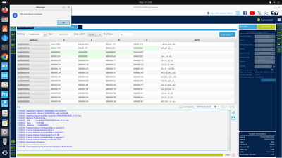

I downloaded and flashed the official demo HEX files from the STM32H7B3I-EVAL package provided on the ST website. Programming is now successful, but I am facing an issue with the TFT display.
Problem:
  • TFT backlight turns ON
  • No graphics, logo, GUI, or display output appears on screen
  • Screen remains blank/black
  • In some demo files (for example: STemWin-STM32H7B3I-EVAL_V1.0.1.hex), all 4 user LEDs              PG13(1) LED1
      MFX IO11 LED2
      MFX IO12 LED3
      MFX IO13 LED4  turn ON after boot
I already checked:
  • TFT ribbon/cable connection
  • Successful flashing through STM32CubeProgrammer
  • Multiple demo HEX files from the package
  • Power supply and ST-LINK connection
Still, nothing is displayed on TFT.

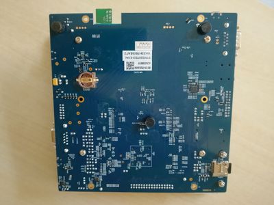

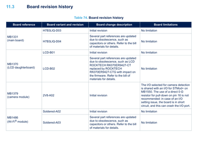

MOBEJ
May 13, 2026

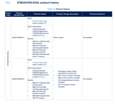

To help identify the issue more accurately, could you please provide:
  1. The board revision
  2. The LCD revision
These details are important because different hardware revisions may behave differently.
For example, in the screenshot:
  • LCD daughterboard: MB1370 B01 — shown in the red rectangle
  • Main board: MB1331 H7B3LIQ-D03 — shown in the yellow rectangle
    You can also find this information on the back side of the board
If you can share both revisions, we will be able to investigate the issue more effectively.
Thank you.
