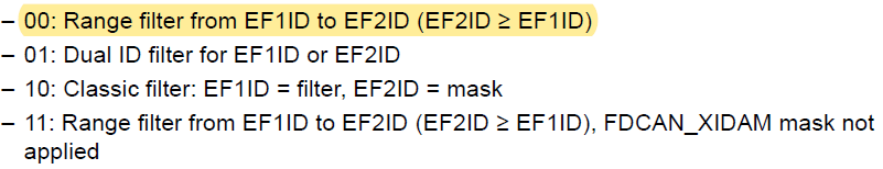

You're using the filter in Mask Mode and that's normal. Try to use FDCAN_FILTER_RANGE instead of FDCAN_FILTER_MASK.

Thanks i tried that. but on receiver side i am receiving the messages from all the IDs into the FDCAN_RX_FIFO0 even after configuring the filter to receive the messages only from a particular ID. In my case i am sending two messages with IDs 0x111 and 0x223 and on receiver side configured the filter to receive the messages only from 0x223 ID but it is also receiving the message from 0x111 ID. my code snippet is shown below:
Thanks for the help. Now i am able to filter out the messages according to IDs.
