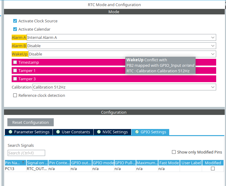

I did the test with the calibration signal at PC13.

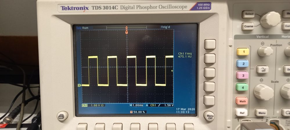

Here is the signal in VBAT mode. (I turned the persistence of the scope to infinity.) The edged are very stable at the same position.

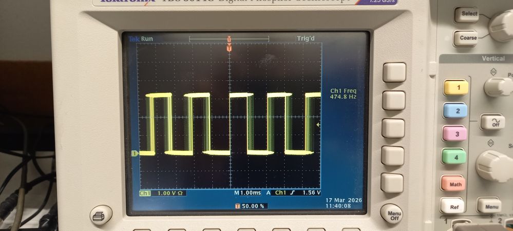

And here the signal in normal running mode, again with infinity persistence:
There is a significant jitter. If I stop the CPU with the debugger, the frequency is stable again.
I have no explanation, why the frequency is not 512 Hz.
I changed the setting for the drive strength to medium-low and to medium-high (regarding the errata). With both setting I can achieve a stable frequency (of 512 HZ! ?:-/) in battery and powered-up mode. I decided to use the real medium-high mode and I'm performing a long-term measurement now. I hope this solves my issue.

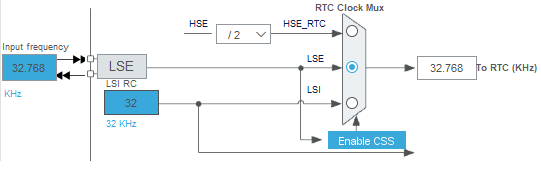

Yes, it seems that you are using the correct clock.
You can double check looking ar reg RCC_BDCR bits RTCSEL for value 0x01.
I would suggest you take out on a pin 512Hz using calbration on RTC_OUT_CALIB and check if you have a stable frequency; that can show if it is normally working fine while some random event can shift LSE oscillator, like spike injected noise.
PC13 is not connected and configured as input with pull-down.

The clock selection is configured correctly:
If I switch it to LSI manually the speed is definitely wrong because of the pre-scalers for 32768 vs. 32000 Hz.

You can select Calibration and see test clock on some pin, here PC13.
If square wave has jitter, you have some noise injected - memory oscilloscope helps.

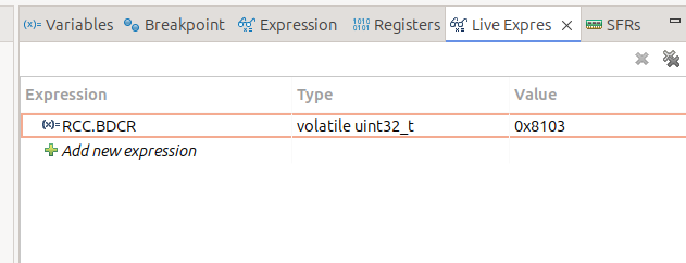

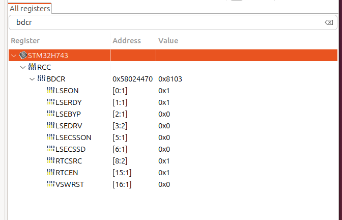

When I suggest double check, I mean looking at registers using debugger after some time - no doubt setup is correct, but some code can overwrite registers.
