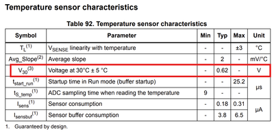

Hi all,
I really hope someone can shed some light on this...
I am trying to find any information regarding the accuracy of the internal temperature sensor of the STM32H7 family, more specifically the STM32H743XIH6.
I understand that each device is factory calibrated to improve the accuracy, however I cannot find what the accuracy actually is, I mean, I cannot find any official source of information, I've seen some saying that it is ±1.5C, but nothing in the ST documentation.
Any help is appreciated.
Thanks

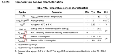

its given in ds ; but need read the TS_CAL + formula in manual:
at 30° : +/- 5° C .
S, do you think this can be interpretated as the accuracy at 30°C
As this is the only given range for the temperature sensor value - yes.
And don't forget, this is not a sensor for really measuring temperature, it's more to get some information about the actual chip temperature: is it in acceptable range or not. Depending on actual work load, it could go up or down some degrees in seconds, so +/- 5C is okay.
Yes, makes sense.
Thank you very much!
