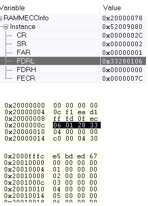

Here is some more info. The FDRL register Of the DTCM1 monitor is shown below.
But the matching data is in DTCM0 which I have not enabled monitoring on.
DTCM1 does not contain the matching data.
-Dave

Looks like my copy & pasted images were removed. Trying again. Didn't notice the big red pop-up warning message about pasting images.

@rammit​ , some of assumptions made are correct, the address is relative and it’s counted by words.
In fact, it is not clear why you see this behavior of wrong address, but CPU and debugger are reading the memory.
Perhaps, you could try clearing the registers after each incident to see if that helps.
Some uncertainty about address is reportedly related to unaligned memory access. Please check this point, is the access aligned to word width?
