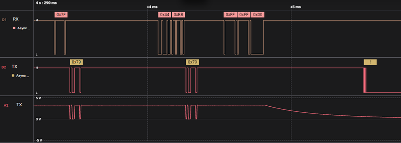

The bootloader process is done via USART1. It fails at the Extended Erase Memory command, where instead of taking the time to erase memory then ACK, it resets.
Any idea what could cause this and how it should be fixed?

At first yes, but then it resets after receiving the mass erase checksum (0xFF 0xFF 0x00). This reset is propagated and visible on the NRST line. After the faulty reset, the program boots back in the application.
On processors that work, there is a delay after receiving the checksum, followed by an ACK, no reset.
From looking at other posts concerning similar issues, the problem might be caused by a peripheral that is not being deinitialized properly, or a memory remapping issue. Is there anything else that could cause this behaviour?

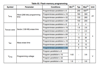

Hi @Simon_L ,
This limitation is seen on some STM32H743 samples where the erase takes more that 6 seconds.
This is due to the TIMOUT value used by the BL when waiting for the ongoing erase operation. The TIMEOUT value is set to 6 seconds, which is grater than the average erase timing (see below image) but less that the max value which is 10 seconds (see below image).
The erase operation seems to take more than 6 seconds on the sample that you have and this is why you see the reset.
Please refer to the table below for more information about the flash Mass erase time.
To overcome this, either:
- Try with another sample with BL version V9.1 (if this is possible for you)
- Implement a code in RAM memory which erase the Flash and don't use the BL to do so (you can program that code in RAM using BL and then jump to it to perform the erase).
- Use a sample with BL version V9.2 ( the Erase timeout value was increased in BL V9.2).
Sorry for this inconvenience!

When checking RCC_CSR for the reset reason, the only reset I was able to identify was the intended SFTRESET right before this interaction, the faulty reset either came out blank (all zeroes) or still SFTRESET. I have monitored the power lines and they don't drop in voltage, and our power supplies should be more than sufficient for the chip's current needs. I have found a solution to my problem through an alternative method which I will detail in another reply. Thanks for your help!
Good to know, thank you. I have found this issue on all BL V9.1 tested (about 5 different chips of different batches). In this situation, wouldn't the reset occur after 6s instead of instantly after the request (less than 1ms)?
