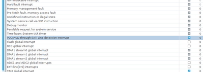

I want to get the PVD on a STM32H743 running in order to write some data to the flash, which did not work for whatever reason. So, as a first step, I tried to implement an interrupt which just pulls a GPIO-pin high and check it with an oscilloscope. I configured "PVD Level 6" (2.85V) and "External Interrupt Mode with Rising Edge Trigger Detection" in CubeMX, and implemented HAL_PWR_PVDCallback() with a GPIO_Write. However, when I disconnect the power supply, the pin is not being pulled high. The duration in which the power drops from 2.85V to 1.6V is approx. 10ms, which I guess should be plenty of time to process the interrupt. I can fire the interrupt with a software trigger (SWIER1) on EXTI line 16 successfully, which tells me that the EXTI interrupt is working in principle. I also checked that PVDE in PWR_CR1 is enabled, as well as the PLS bits for the threshold.

  /* PVD_AVD_IRQn interrupt configuration */
  HAL_NVIC_SetPriority(PVD_AVD_IRQn, 0, 0);
  HAL_NVIC_EnableIRQ(PVD_AVD_IRQn);

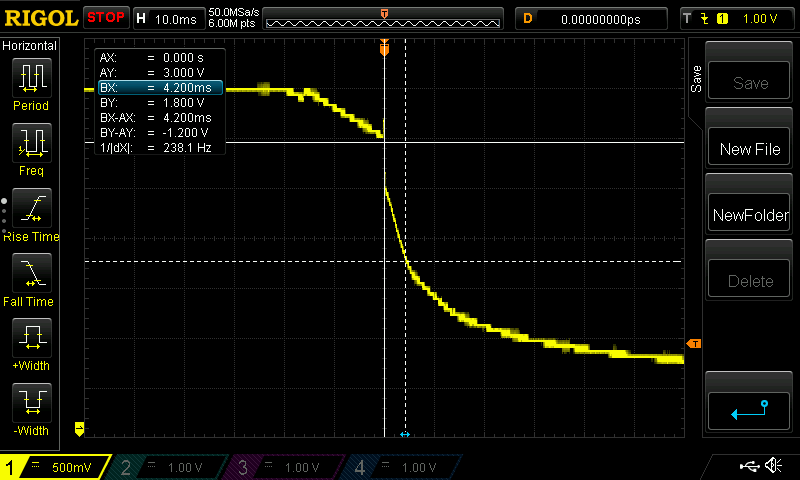

No matter what, the interrupt is not triggering (in the ISR I'm driving a GPIO to high level, but I'm not able to see it changing the status). As MaxMax, I can fire the interrupt with a software trigger (SWIER1) on EXTI line 16 successfully, which tells me that the EXTI interrupt is working in principle.
VDD and VDDA are on the same power bus, and it takes approximately 4.2ms to drop from 3V to 1.8V (I'm running 160Mhz clock, so 4ms should be enough to move a GPIO).

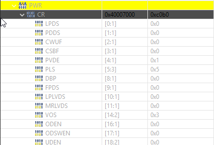

Read out and check/post content of PWR_CR.

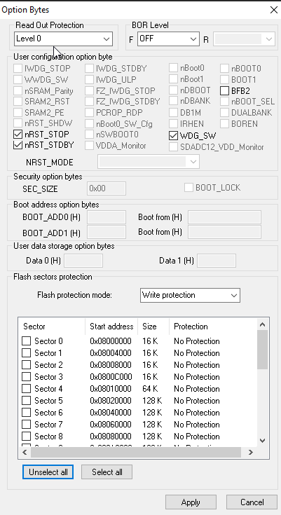

Do you use Brownout Detection (i.e. what's the value of FLASH_OPTCR.BOR_LEV)?

  registers[0] = PWR->CR;

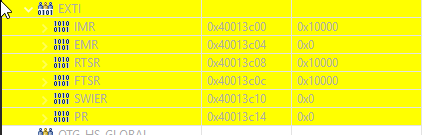

  registers[1] = EXTI->IMR;
  registers[2] = EXTI->FTSR;
  registers[3] = EXTI->RTSR;
  (void) registers;
  while (1)
      if (PWR->CSR & PWR_CSR_PVDO)
          HAL_GPIO_WritePin(GPIOA, GPIO_PIN_12, GPIO_PIN_SET);
      else
          HAL_GPIO_WritePin(GPIOA, GPIO_PIN_12, GPIO_PIN_RESET);
1) contents of PWR_CR and EXTI registers seems correct.

3) Brownout is disabled

I've tried also using regulated power supply (3v3). It seems that CPU is resetting almost immediatly as voltage drop down to 3V: shouldn't be 1V8?
I'll try an EVB, maybe it's an hardware problem of my board.

alessandro morniroli
My bad,
I've just realized that on the board, on the MCU_RESET line there is a LM809M3-3.08 chip that is resetting my MCU @ 3.08V : )3
waclawek.jan
Thanks for coming back with the solution.
