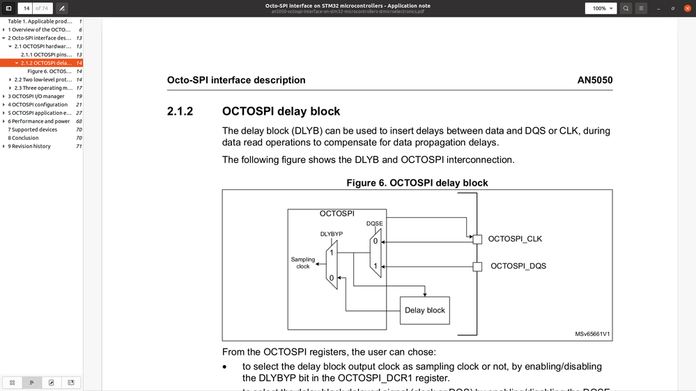

Yes sure you need to enable SEN and DEN to allow the Delay Block validate the setting but the problem here is that you need a free running clock to validate any setting and the Delay Block Input must be connected to the clock...
Let me show you a picture:
I hope the picture taken from annex an5050 is visible.
My problem is that when the hyperbus memory type is selected for the octospi, the delay block input switch automatically to DQS that is correct in general during normal access to the HyperRam but it is wrong during the calibration or any delay block setting because we need a free running clock and the input connected to that clock.
This happens only for HYPERBUS Memory Type that is the type I need to configure....
Yes, SEN and DEN bits need to be set because they enable the sampling of the free running clock.
Without this clock any configuration won't be valid (the valid flag LNGF in CFGR won't be set).
I'm not sure that is the same for any platform but it my case that is stated by the manual :

I struggled a lot as you but my problem was not the free running clock setting (done correctly). The problem with my SoC was this setting:
OSPIHandle.Init.MemoryType = HAL_OSPI_MEMTYPE_HYPERBUS;
When configured in this way It was impossible to tune it but I found the workaround explained above.
With STM32H7B3 and Hyperbus the behavior is odd. It seems only possible to delay the DQS signal so for using free running clock the only chance was to calibrate as I was using a different memory type.
When calibrated I can set the delay line correctly with no issues...
It would be nice if STM could check what I'm stating and give a reply on STM32H7B3...
I checked on Cube many examples and my feeling is that different SoC can have different ways to approach the same topic.
Delay block calibration and usage can be different even if the general idea is the same..
Thanks for sharing your experience.
It can be very helpful for others having the same troubles
Carlo
