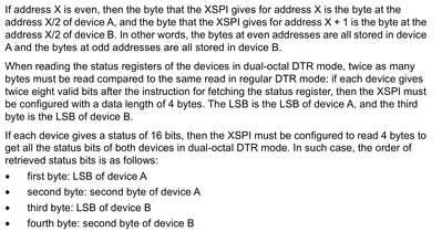

KDJEM.1
Hello @Happybolt;
What do you mean by DMM register?
For more information about reading status register and addressing; I recommend you to look at RM0477 Rev9 section Dual-octal configuration.
I hope this help you.
Thank you.
Kaouthar

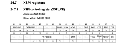

Bit 6 DMM: Dual-memory configuration This bit activates the dual-memory configuration, where two external devices are used simultaneously to double the throughput and the capacity. 0: Dual-memory configuration disabled 1: Dual-memory configuration enabled Note: This bit can be modified only when BUSY = 0.

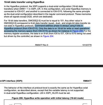

What I found in RM0477:
"Command-address phase is always using 8 bits in HyperBus protocol (from IO0-IO7). Only the data is on 16-bit for write or read operations accessing the memory space (from IO0-IO15)."
"For memory register accesses, the data is on 8-bit (from IO0 to IO7, IO8 to IO15 being not used but driven by the controller)."
This suggests that in 16-bit dual-memory HyperBus mode, register space access only works through IO0-IO7 (Chip1), and Chip2 (IO8-IO15) is completely ignored during register access.
Question: Is it possible to configure CR0 registers of both chips in dual-memory mode? If so, how? Do I need to temporarily switch to single 8-bit mode with separate CS# for each chip to initialize the registers?
