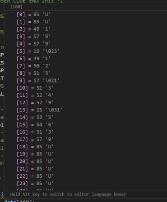

we are using the STM32H7R7I8T6 MCU with an Infineon S70KL1282 HyperRAM Chip attached on XSPI1 and configured via CubeMX, we are looking for an example for the correct timing/parameters to use the RAM Chip in memory mapped mode as Graphics RAM.
Our current config makes makes reading and writing possible but the memory contains garbarge data.
We are repeatedly trying to write the string "1234567890" into the external RAM but we get back the following:

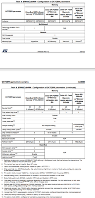

Hello @dhAvionics,
You can find more details about the XSPI settings description in AN5050 Table 8.  STM32CubeMX - Configuration of OCTOSPI parameters.
Could you please try to decrease the XSPI frequency. Is the issue solved?

KDJEM.1
Hello @dhAvionics ;
Could you please check RW recovery time and Access time.
 Read/write recovery time (TRWR) define the device read/write recovery time, expressed in number of OCTOSPI clock cycle, configured depending on the memory datasheet.
Access time (TACC) is expressed in number of OCTOSPI clock cycles, configured depending on the memory datasheet.
Thank you.
Kaouthar

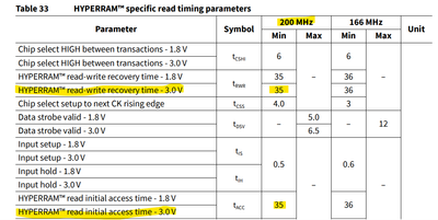

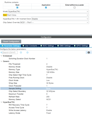

dhAvionics
Thank you very much @KDJEM.1;
We tried the values from the datasheet (35ns @ 200MHz = 7 Cycles for both)
In the datasheet we found the following default values for the timing:
Initial latency: 7 Clock latency @ 200 MHz/166 MHz max frequency
Fixed latency enable: 1 - Fixed 2 times initial latency
Hybrid burst enable: 1: Wrapped burst sequence in legacy wrapped burst manner
Burst length: 32 bytes
We ended up with the following config but it still produces garbarge Data and sometimes hangs the chip:
it is unclear for us which values corrospond the the items in the list.
For example: what ist "Refresh Rate", "Maximum transfer", ...?
Is there an example maybe?
Again, thank you for your help.
