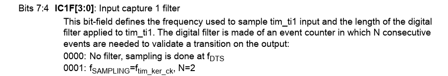

You connect pwm output with a wire to capture input pin - right ?
Then the external signal is going to input filter and is synchronized to the internal timer clock.
This needs minimum 1 clk.
see rm , timer x :

Hello @Tkmn
As @AScha.3 already mentioned, this lag could be primarily driven by the filter value set in the CCMR1 register.
Incorrect filter values can cause a delay in the input capture measurement, you can manually modify the register to set the correct bit.
Please note that this might not be the only factor (configuration of the timer, the clock speed,.. )

My CR1 value is 129 and my CCMR1 value so I think it should be sampling at 240MHz and not applying filtering. I can try to increase the rate to 480 MHz to see if it halves.
