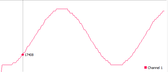

I am using the stm32h7 to sample 4 channels from adc1 using the DMA.
I am using circular mode with half word size. I start the dma and let it fill up a memory buffer:
volatile uint16_t adcInsDMA[4*ADCBLOCKSIZE] = {0};
HAL_StatusTypeDef status =  HAL_ADC_Start_DMA(&hadc1, (uint32_t*)&adcInsDMA[0], 4*ADCBLOCKSIZE);
This works, however It looks like I am only getting 6bits of resolution. and not 16.
I consistently get only 63 distinct value no matter when I sample, or what the speed is of the incoming signal etc.

Even when using a very minimal ADC only program I get the missing LSB bits, oddly, the exact same program works fine on my NUCLEO dev board.
waclawek.jan
My guess is, problematic/unstable VREF+ and/or VREF-/VSSA.

Gudgel.boB
Senior
You sure this part allows ADC_CLOCK_ASYNC_DIV1 at 16 bit resolution ?
When you apply Vdd to the ADC input(s), which of the 16 bits are zero in the result register or buffer ?
TCash.1
Hi Gudgel,
When I apply Vdd I get 1111 1110 0000 0000 (65024)
When I apply GND I get 0000 0010 0000 0000 (512)
all intermediate value still scale accordingly but with the least significant 9 bits always zero.
I tried increasing the clock prescaler to 4, and I begins to work again. It is odd to me though why clock prescaler = 1 worked on STM32H743ZIT6U . My Part is STM32H743ZIT6. Maybe the missing U is part of it.
In any case I think clock prescaler is the fix I'll go with for now! Thanks!
