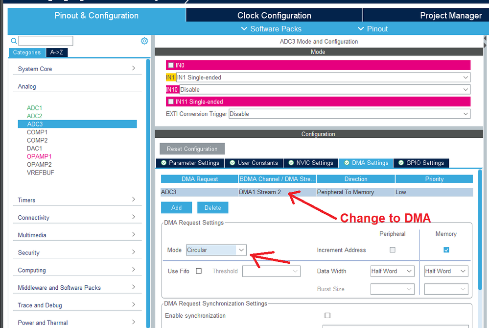

‎2024-04-04 12:28 AM - edited ‎2024-04-04 12:34 AM
Thank you, it worked for me, I used another stream and no problem :)
To make that at the cubeide in the ADC3 you must go to DMA, add and then change in the BDMA to a DMA and stream not used by other ADCs
