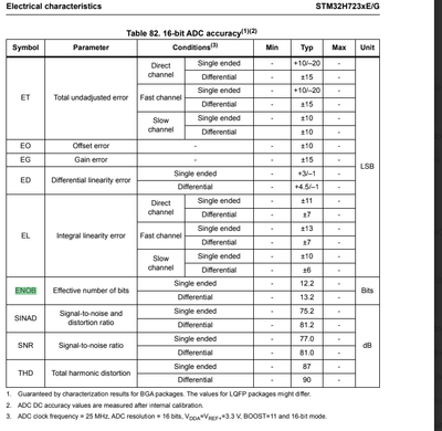

HAL_ADCEx_Calibration_Start(&hadc1, ADC_CALIB_OFFSET, ADC_SINGLE_ENDED);The error is not fixed, for example if i give 0v i might get 1-2mV error, but for 2V it might be 1-20mV. I tested the error using Keithley 2450 source meter. All the clocks are in the default configuration, also for ADC, clock is derived from HSI, will that affect accuracy? From the docs the ENOB is 12.2, so that mean 7mV/step. Also is the Total unadjusted error and ENOB same?

About ENOB and total unadjusted error, I really don't know. I suppose that if ENOB is 12, precision would be 3300 mV divided 4096, or 0.8 mV. Considering instead 3300 mV divided by 16-bit steps, it would result in a 0.05 mV per step; an unadjusted error of 10 LSB would mean 0.5 mV (10 steps of 0.05 mV), which is not too far from 0.8 mV, but it is not the same. As you see, I'm not an expert.
