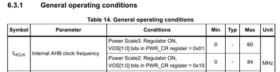

Could this have something to do with it?
Hard fault on high clock speeds suggests a hardware issue, not a code issue.
Is this a custom board? VCAP voltage okay? Power sufficient? Wait states set appropriately?

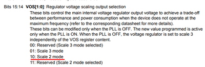

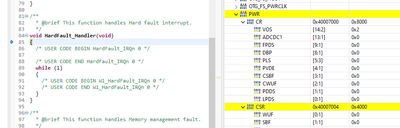

I didn't do any configuration for this but I can see it is already configured as Power Scale 2, even before HAL_RCC_ClockConfig function. It is also set in the hard fault handler.

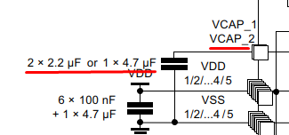

If so, did you refer to the STM32F4xxx hardware getting started application note AN4488, especially the schematics on page 34?
It turned out it was hardware issue as you stated. Unfortunately I saw this post (same issue) after I shared my post. I contacted to the hardware team and asked if VCAP is correctly placed and has 1.26V on it, they found out there is problem with paths and they fixed. Now its working fine. Thank you everyone!
Guys who have same issue be sure VCAP1 has below capacitor and voltage values:
