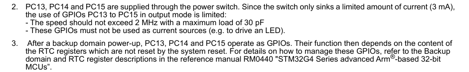

PC15 , from ds :
So these pins are on backup domain ;  you have it working ? (Vbat supply ? )
+ read RTC description...or set it in Cube .
