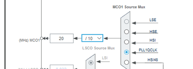

Come on...see here, core at 200M , mco /10 , so 20M to check outside:
And set pin speed high...otherwise maybe see nothing.

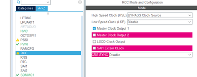

...and mco has to be enabled:
