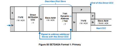

Concerning your point, normally the first byte sent is 0x7F, not 0x3F, as it correspond to the header arbitration, come from MIPI specification.
As example for a SETDASA command, here is extraction of MIPI specification:
Or for private communication:
If you do not want an arbitration header, you can use LL interface:
LL_I3C_DisableArbitrationHeader
Hope that help
