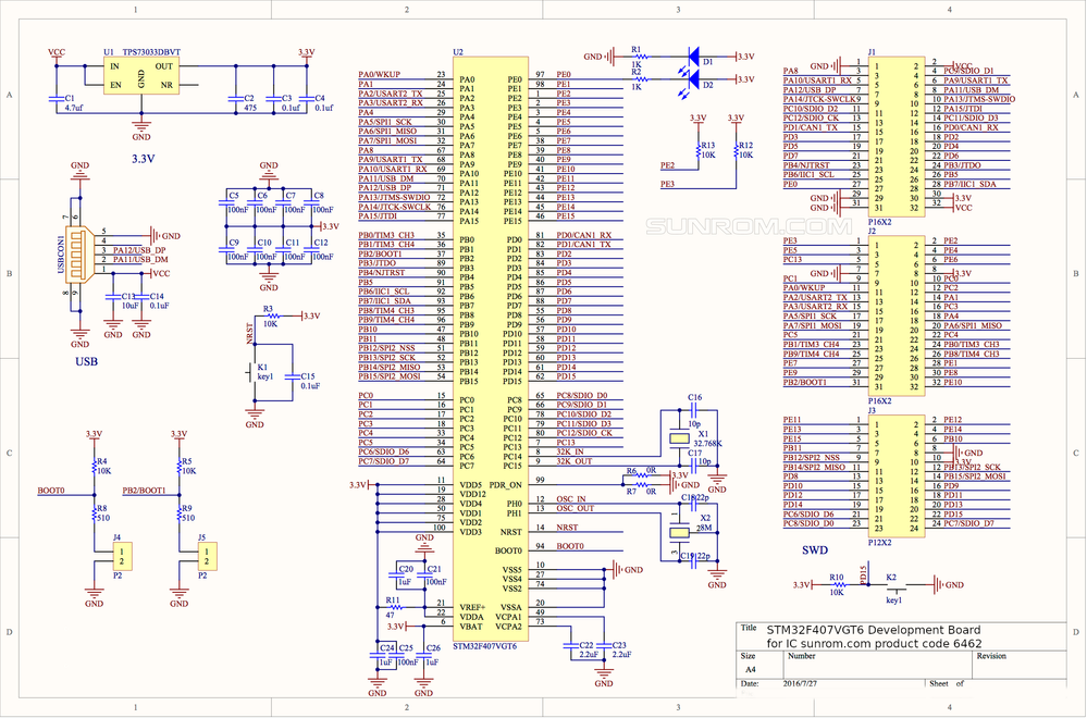

I have diymore stm32f407vgt6 board , I connect usb  give DEVICE NOT RECOGNIZED  if i try DFU mode BOOT0 >3.3V, BOOT1 > GND, I try  every thing  but nothing . please  help mee
This board has issues.
You'd be better off getting a nucleo board with a built-in programmer. Programming over the USB DFU connector is a recipe for disaster and unproductiveness.
Especially problematic:
PDR_ON shorted to both 3V3 and GND. (Pictures show both R6 and R7 are fitted.)
Also:
VDD not tied directly to VDDA.
ID pin of USB connector not tied to GND.
VCPA typo in schematic.
And my favorite, they have a typo in the silkscreen in the company name

Could you provide more details about your schematic and the context of your project?

download (3).jpegdownload (2).jpeg I use stm32f407vgt6 board by DIYMORE  this is schematic. I try to make remote controller EDGETX radio transmitter.  the problem is when i pluged  usb and connect with microcontroller  desktop give warning notification  ( USB device not recognized) and check in device manager> Universal Serial Bus controllers  section showing Unkown USB device(Device descriptor request failed). try many thing and download many driver .still not work
Also:
