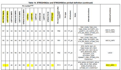

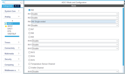

STM32H563 ADC
‎2023-08-08 9:04 AM
‎2023-08-08 9:27 AM - edited ‎2023-08-08 9:31 AM
The pins don't exist on that chip.
‎2023-08-08 9:32 AM
Thank you. It would be helpful if RM0481 mentioned that.
‎2023-08-08 9:36 AM
DS14258 mentions this.
‎2023-08-08 9:46 AM
Chip specific things will be found in the datasheet.
