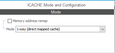

jowakar122
Senior
Does it have to do anything with ICACHE?
