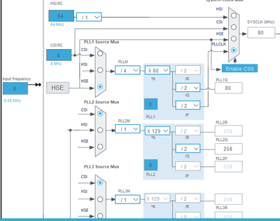

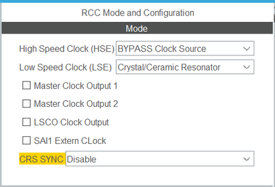

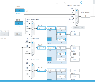

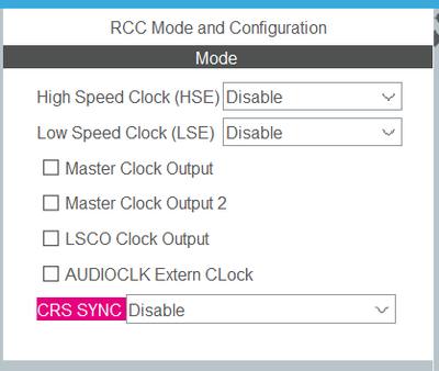

Thanks for the response.
What part of the communication "is not working"? Transmit or receive?
----------I am testing both transmit and receive. But none of them is working.
What hardware are you using? a NUCLEO-H563ZI? you can use any pin supporting FDCAN function except the ones connected to something else on the hardware
----------Yes, NUCLEO-H563ZI. I am using the pins supporting PB8 and PB9.
For normal mode you need a second node connected to the CAN bus, what is the second node? does it have the same bitrate?
-----------I have connected to PCAN view with the same bit rate and frequency.
What clock source are you using for the FDCAN? you need a crystal for CAN communication.
I have tested the same with STM32H533RET the CAN protocol, It worked fine without the external crystal oscillator.
I made the PLL1Q to 80MHz which is the input for the CAN protocol.
Please let me know if i have made any issues with the clock settings.

As you told, I tested the board stm32H533RE Nucleo board with the external crystal of 24MHz. I configured the CAN peripheral to 80 MHz and checked with PCAN view. It worked successfully. I can able to send and receive the data. But when I configured the clock peripheral to 150 MHz, I could not see the data in the PCAN view. (Please Note: Both are configured to 500Kbps with prescalar and Time segments).My question if I configure my clock frequency to 150MHz, Will the classical CAN works. Thank you for your support. May i know where can i find the example project for stm32h533RE or any links might be helpful
