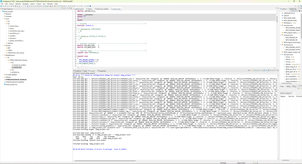

Hello @tizdipietro
Based on your IOC , you are using MX 6.15.0.
What I recommend you to do is migrating to the lates version 6.17.0

Hello @tizdipietro
