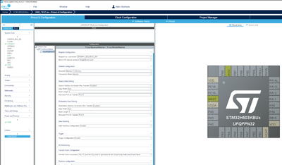

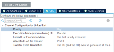

nix
hi, i just had a similar problem and i managed to get something togather.
its reading the temperature sensor and the adc vref with the GPDMA in circular mode.
it seems that cube MX is not generating the node init at all on the H503 and on the H563 it is missing the  "LL_DMA_ConfigLinkUpdate"

	NodeConfig.UpdateRegisters = (LL_DMA_UPDATE_CTR1 | LL_DMA_UPDATE_CTR2 | LL_DMA_UPDATE_CBR1 | LL_DMA_UPDATE_CSAR | LL_DMA_UPDATE_CDAR | LL_DMA_UPDATE_CTR3 | LL_DMA_UPDATE_CBR2 | LL_DMA_UPDATE_CLLR);
	NodeConfig.NodeType = LL_DMA_GPDMA_LINEAR_NODE;
	LL_DMA_CreateLinkNode(&NodeConfig, &Node_GPDMA1_Channel0);
	LL_DMA_ConnectLinkNode(&Node_GPDMA1_Channel0, LL_DMA_CLLR_OFFSET5, &Node_GPDMA1_Channel0, LL_DMA_CLLR_OFFSET5);
	LL_DMA_SetLinkedListBaseAddr(GPDMA1, LL_DMA_CHANNEL_0, (uint32_t)&Node_GPDMA1_Channel0);
	LL_DMA_ConfigLinkUpdate(GPDMA1, LL_DMA_CHANNEL_0, (LL_DMA_UPDATE_CTR1 | LL_DMA_UPDATE_CTR2 | LL_DMA_UPDATE_CBR1 | LL_DMA_UPDATE_CSAR | LL_DMA_UPDATE_CDAR | LL_DMA_UPDATE_CTR3 | LL_DMA_UPDATE_CBR2 | LL_DMA_UPDATE_CLLR),(uint32_t)&Node_GPDMA1_Channel0);
  /* USER CODE END GPDMA1_Init 1 */
  DMA_InitLinkedListStruct.Priority = LL_DMA_LOW_PRIORITY_HIGH_WEIGHT;
  DMA_InitLinkedListStruct.LinkStepMode = LL_DMA_LSM_FULL_EXECUTION;
  DMA_InitLinkedListStruct.LinkAllocatedPort = LL_DMA_LINK_ALLOCATED_PORT0;
  DMA_InitLinkedListStruct.TransferEventMode = LL_DMA_TCEM_LAST_LLITEM_TRANSFER;
  LL_DMA_List_Init(GPDMA1, LL_DMA_CHANNEL_0, &DMA_InitLinkedListStruct);

hi, the H503_TEST.ioc file is in the above attached H503_TEST.rar file.
to complete the list of problems that occur (for me) with that adc to dma stuff:
  1. in the ADC1 tab, i set the dma continuous request to enabled, but:
    ADC_REG_InitStruct.DMATransfer = LL_ADC_REG_DMA_TRANSFER_UNLIMITED;
    is not generated, without it dont seems to request the DMA
  2. with the H503KBUx selected, i can configure almost nothing in the GPDMA tabs
    so it only generates the DMA_InitLinkedListStruct.
    (with the H563) it it does generate the nodeconfig and the Node_GPDMA1_Channel0 init.
  3. on both (H503 and H563) the LL_DMA_ConfigLinkUpdate is missing, without the DMA starts with no init and will set the user error flag
the GPDMA node should be initialised as static.. it works in the code i posted, but in my main project where i do more then just ADC to DMA the ram gets changed and as the GPDMA reads the node continuous it must stay what it is.
i think thats it so far

Hello again @nix
After more discussion with the CubeMX dev team, the points 2 and 3 are not really issues,
in fact, to configure the GPDMA tabs, you have to do it in utilities as shown here:
a file named linkedlist.c will be automatically generated and you won't need to manually add the LL_DMA_ConfigLinkUpdate or any other other configuration!
Sorry for the misunderstanding, I hope it's more clear now!
