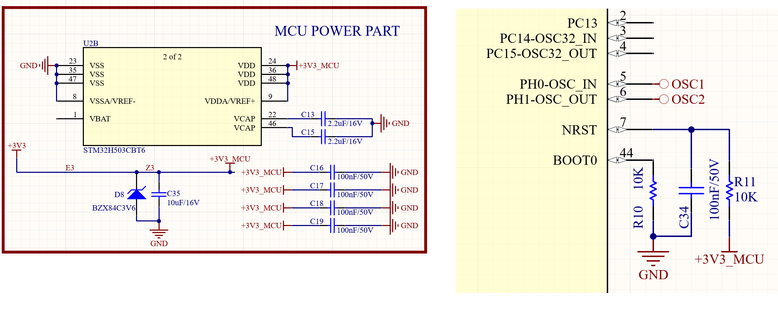

I couldn't even get this stm32h503 chip to work. After 10 minutes of working, the reset pin goes to low and it doesn't work anymore. We think this product is completely faulty. Were you able to get it to work? Which product are you using exactly?

If you know of a problem that will cause the product to burn and break, I am open to any help.
Does it fail using just the connections shown?
Anything connected to the other 30 pins?
