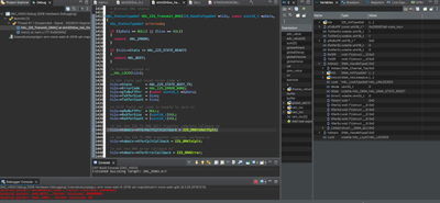

I'm about to program a continously running DMA stream (using GPDMA1 (circularly))  in an STM32H503CBU6. But the start already fails.
during the setup of the i2s->hdmatx pointer is zero causing the crash when it wants to get initialized.
I'm in need of a running example with an I2S device configured with a continously running DMA write stream
with a length of 1 (32 word) to the I2S device. Help urgently needed, please.

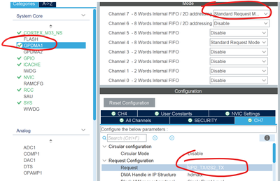

DMA
Set up a GPDMA channel to service I2S2_TX requests. You don't have one assigned.
6 REPLIES 6
Please include your IOC file. The DMA pointer should get initialized in the mspinit function. Needs to be enabled in the IOC.
IOC file attached.
Ah, thanks. I see "Request configuration", there is SPI2_TX/I2S2_TX !
I'll try to get further.  Only about the mode I'm not sure. Wouldn't I have to choose circular mode when the DMA should keep itself ongoing?
Yes, if you want it to continue forever you will need to enable circular mode.
