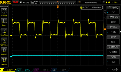

I use STM32H562 and/or STM32H503 (nucleo board). When try in loop only this line:
while (1)
GPIOB->ODR ^= GPIO_PIN_6;
The frequency on pin is only 12.5 mhz. I use external quartz 8mhz (and 24mhz on nucleo)

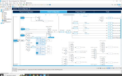

I config  to 250mhz (with build-in CubeMX ) :
void SystemClock_Config(void)
__HAL_PWR_VOLTAGESCALING_CONFIG(PWR_REGULATOR_VOLTAGE_SCALE0);
while(!__HAL_PWR_GET_FLAG(PWR_FLAG_VOSRDY)) {}
RCC_OscInitStruct.OscillatorType = RCC_OSCILLATORTYPE_HSE;
RCC_OscInitStruct.HSEState = RCC_HSE_ON;
RCC_OscInitStruct.PLL.PLLSource = RCC_PLL1_SOURCE_HSE;
RCC_OscInitStruct.PLL.PLLM = 2;
RCC_OscInitStruct.PLL.PLLN = 125;
RCC_OscInitStruct.PLL.PLLP = 2;
RCC_OscInitStruct.PLL.PLLQ = 2;
RCC_OscInitStruct.PLL.PLLR = 2;
RCC_OscInitStruct.PLL.PLLRGE = RCC_PLL1_VCIRANGE_3;
RCC_OscInitStruct.PLL.PLLVCOSEL = RCC_PLL1_VCORANGE_WIDE;
RCC_OscInitStruct.PLL.PLLFRACN = 0;

Why is output frequency is too low ?. In assembler are no more 5 lines. So must be arround 50mhz.

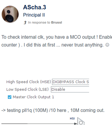

and you set speed for mco hi ?

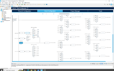

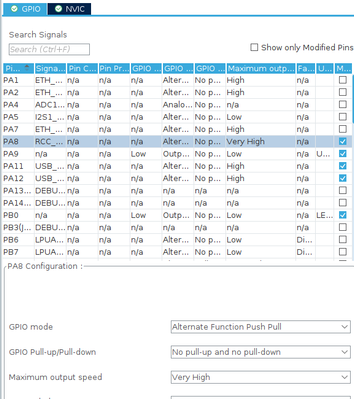

Yes i have set " very high" speed. I see other interestig: if i choice source to MCO1 to be HSE or CSI , on MCO1 pin have a signal. And signal is exacly frequency according source , BUT if i choice PLL1QCLK - NOT SIGNAL.:
btw
set the pll1 fractional divider :0
I set it 0 or other value , no mater. Just check and you will see that if you select for source PLL1Q - not signal !! Just test it. I see you dont trust me. JUST TEST !

as i said: i tested this first, to proove , i set clk correct.
try same setting (100M -> mco/10) - otherwise i have no idea, why it shouldnt work on your H563.

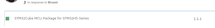

Which is you version of HAL?
again ??
IDE v 1.13.1
