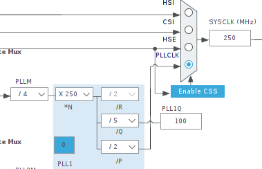

To check internal clk, you have a MCO output ! Enable it, select the clock to test and test on mco pin with scope (or counter ) . I did this at first ... never trust anything. :)
-> testing pll1q (100M) /10 here , 10M coming out.
+ here SystemClock_Config , just as cube puzzeled it together:

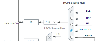

Interesting is that on MCO1 pin not signal !!
I try and on other custom board with STM32H562 and result is the same.

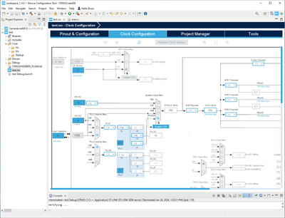

This is photos of clock config:
Some one to help ? I can't start project 3 days. Just simple 250mhz setup i can't make with extarnal qartz. Where is f..ng problem. I use last lib of stm32H5 1.1.1. My be something in library  is not OK!? Why frequency a half of 250 mhz and why on MCO1 pin not signal ? I check frequency of quarts and is 24mhz. So my scope measuring ok.
I see when use HAL_Delay(1) that delay time is not 1 ms but 2ms. SUPER STRANGE !!!
So first : why on MCO1 pin not signal ? This cannot be...we dont allow! :)

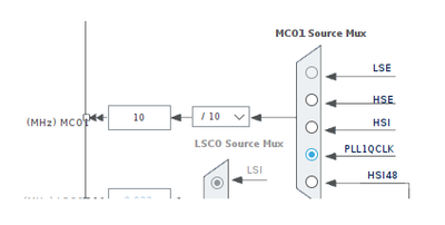

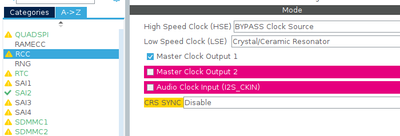

set mco in Cube (?) ->
then set the mux:
and check : input is the real value on your board ? :
on my H563 nucleo : is 8MHz !
Now check mco1 output ...!
