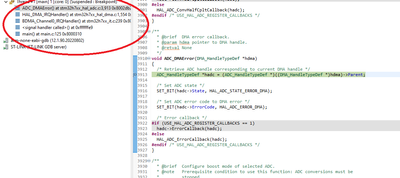

I have problem with functionality of DMA data stream for ADC3 peripheral. I have H743ZIT controller. ADC1 with DMA is fully and properly working for each channel. I have placed ADC data array to RAM_D2 section for ADC1.

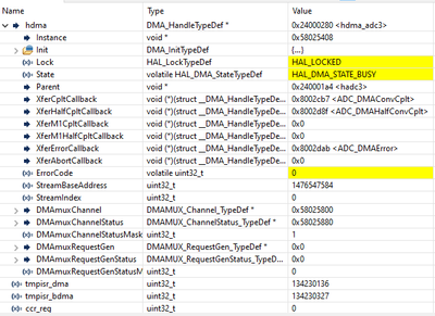

For ADC3 I have used RAM_D3 section which should be proper for BDMA implementation. ADC3 seems to work good - because I see changes in DR register, but DMA transfer error occur immediately after HAL_DMA_IRQHandler is executing. Exactly this case is true:
"else if (((tmpisr_bdma & (BDMA_FLAG_TE0 << (hdma->StreamIndex & 0x1FU))) != 0U) && ((ccr_reg & BDMA_CCR_TEIE) != 0U))"
It leads to HAL_DMA_ERROR_TE error code.

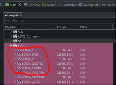

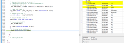

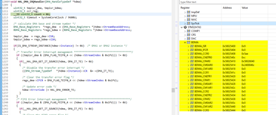

Probably the memory being accessed is not accessible by the (B)DMA. Can you show the relevant BDMA_Channel0 registers at the time of the error?
sagit
I hope this is what you are requesting.. Thank you very much.
Actually, I meant the registers themselves. If you pull up the SFRs window (Window -> Show View -> SFRs) when you're debugging, you can look at the register values directly.
That show's what's really going on at the chip level.
